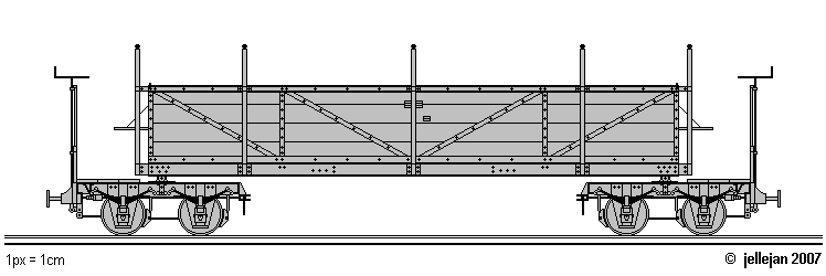

Open wagon:
Body length (without trucks): 65mm / 4812mm = 1:74
Body width: 20mm / 1735mm = 1:87
Height of wooden boards: 7mm / 700mm = 1:100
The wooden boards are the new type, the thin frame however is the old type (by changing parts this could exist in real world).
As far as I know, in Macedonia all open cars were the old type.
Trucks:
The sides of the trucks are the old type, the hand rails (with brake) are the new type (this does not exist in real world)
As far as I know, in Macedonia all trucks were the old type.

Open wagon:
>>> The wooden boards are the new type, the thin frame however is the old type (by changing parts this could exist in real world). <<<
Correction:
>>> The wooden boards and the high frame are both the new type (so no mistake by Minitrains !) <<<
(so, only the trucks are a mixture of the old and new construction type)
Greetings, Jelle Jan
